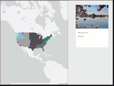

Until we support more expressions to manage what is shown in the text widget here is a workaround:
Use a default in the text box and use view for empty selection in the feature layer under the data panels so it uses default values if nothing is selected. By design, it will pull in the first record from the feature layer. You could have that record blank if nothing is selected. For example, the animated gif below has a default value for Washington D.C. if nothing is selected.

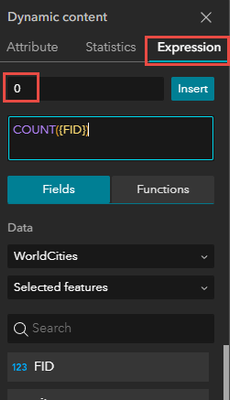

ShengdiZhang
Hi,
You can use Expression instead of Statistics, and use "0" for the expression title.
Shengdi
RichlandGIS
Thanks Shengdi,
I tried the expression, but didn't think to rename it and didn't like "Expression 1" result when zero.
Though, I still think this is a bug (since the "count" actually is zero and not being reported), this workaround does the trick.
R_
