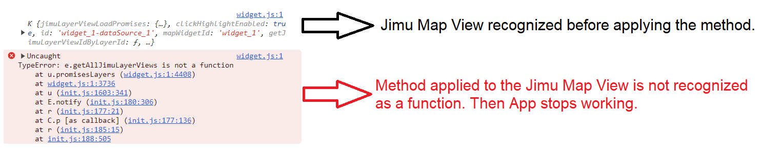

I continue working in the development of custom widgets for Experience Builder and I would like to have some help with a problem that came up.
Basically, the custom widget will ask three different layers from a map widget on ExB App within Portal 11.1 to perform later some different actions. In the 'Setting' code, a Map Widget Selector is used to define the map source from which the layers will be taken. Meanwhile, into the 'Widget' code the JimuMapViewComponent is implemented to pass the selected Jimu Map View and perform a query selection of the features that intersect the map view extent.
The problem shows-up just when I deployed the widget into my ExB App into my Portal and it shows the message that can be seen in Image 1. But when I am working with the builder (development environment) this problem does not show-up and the query action is performed successfully.
Image 1. Error showed by ExB App on Portal.
Attached to this message please find the 'Settings' and 'Widget' scripts. I hope someone can help me or recommend me some sources where I can have a better understanding of this problem. I have searched the solution but I did not have luck with it.

Note that ArcGIS Enterprise 11.1 uses Experience Builder 1.10. Since the API Reference page only contains the current version, you'd have to download the documentation to see if the JimuMapView class contains the getAllJimuLayerViews method for that version.
**Update**
That method first shows up in the index.js file in D:\ExperienceBuilder\ArcGISExperienceBuilder_114\client\dist\jimu-arcgis. The method isn't found in previous versions. It would be quite helpful if they would include the version that classes and methods were introduced, like they do in the ArcGIS Maps SDK for JavaScript API reference. I've added as an Idea for this.
**Update**

Hi Ken, thank you very much for your comments and analysis. I could solve the problem and you were right, I just changed the method and use a new way to access my layers according to ExB 1.10. Now my widget is working into my ExB App on my Portal.
