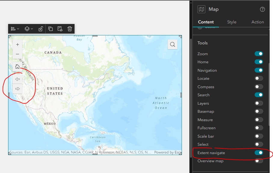

AlixVezina
@SunniBoulton Another option would be to enable the Extent Navigate tool from the Map widget tools so you can go back and forth between different extents of the map that you've explored.

AlixVezina
SunniBoulton
Thank you - that's a great idea - I knew it would be simple!
