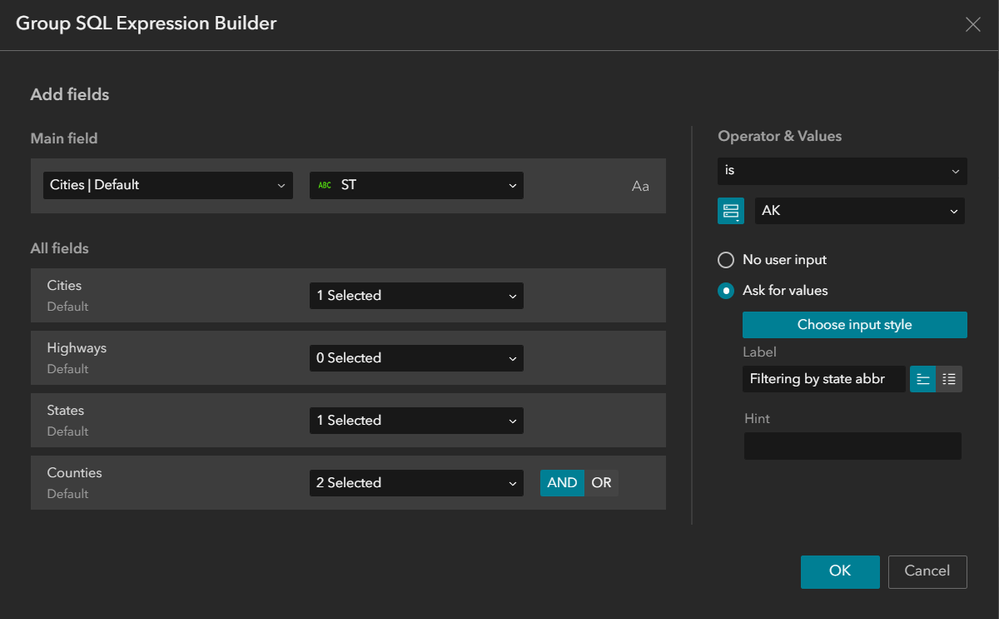

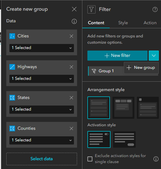

The new group filtering capability has been provided in the Filter widget, along with the latest AGOL release:
Add a group for multiple data sources

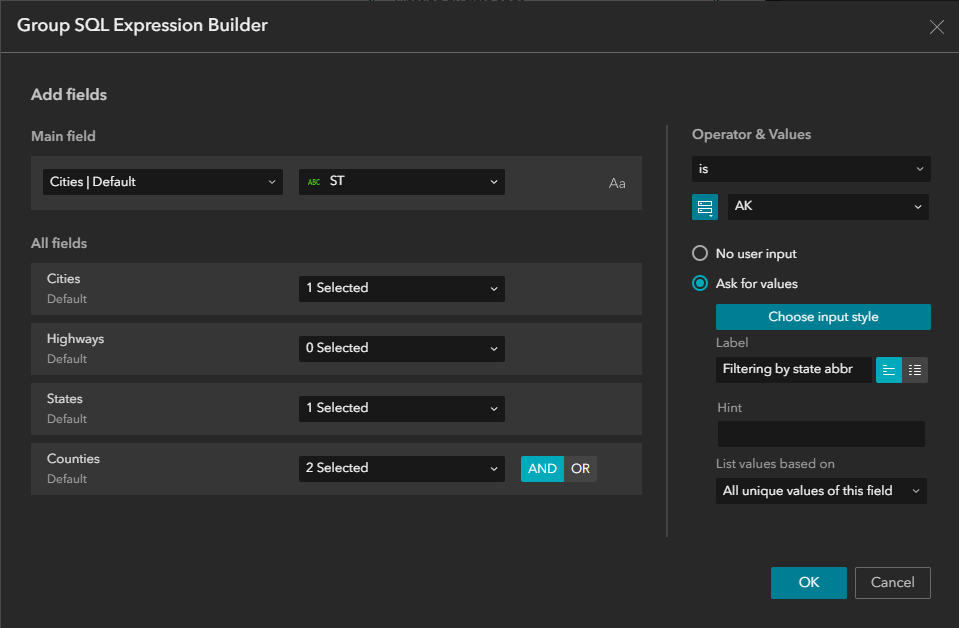

Add expressions using the Group SQL Expression Builder

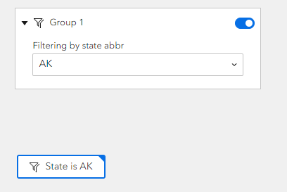

At runtime, use the same style with a regular filter item to filter across multiple layers:
