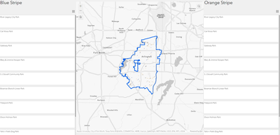

For this demo, I have made a map with two copies of the same feature layer. One is symbolized by blue stripes and the other has orange stripes. I have a map and two list widgets for each of the two layers.

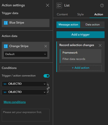

In the Blue Stripe List, I add a Message Action > Record Selection Changes > Framework > Filter Data Records. And set the Action Data to Orange Stripe and set the Trigger/Action Connection to OBJECTID on both layers. The top dropdown menu represents the trigger data (Blue Stripe) and the bottom menu is the action data (Orange Stripe).

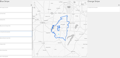

Selecting a Blue Stripe park will filter the Orange Stripe parks.
It seems like you should be able to extend this a little further and make a filter that filters both layers at once, but it just doesn't quite work. Sorry, I couldn't do it. The limitation here appears to be that widgets in Experience Builder are not allowed to chain react. Widget A can make widget B do something, but widget B will not pass it along to widget C. I would love to be proven wrong if anyone can figure this out and I will revisit this topic should Experience Builder add the capacity to filter two layers at once.
