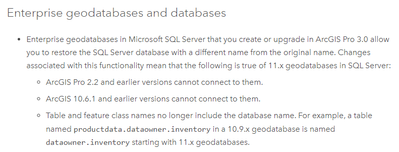

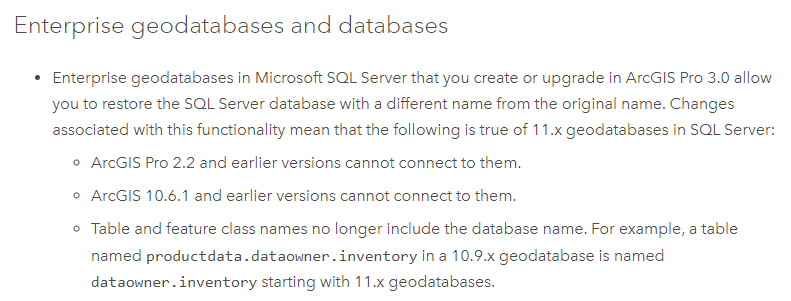

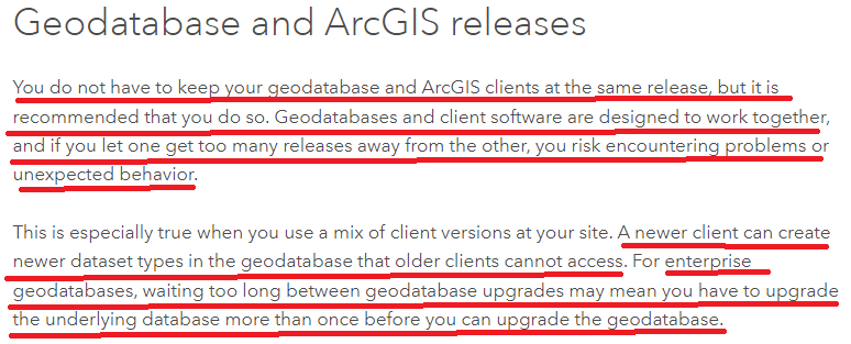

Currently, egdb is on 10.8.1 on a SQL Server 2019, Enterprise deployment (server/portal clients) are on 11.1. All desktop users are using Pro 3.2, with a few exceptions that have been tough to completely pull away from ArcMap. From what I understand, it isn't inherently bad to have different egdb and client versions, though it is recommended to keep them in step. I was reading about upgrading egdb and came across this article: Upgrade Enterprise Geodatabase in SQL Server In particular, this passage caught my eye:
"When you upgrade a geodatabase in SQL Server to 11.0 or a later release, the fully qualified names of tables and feature classes will no longer contain the database name. For example, a feature class named productdata.dataowner.inventory in a 10.9.x geodatabase will be named dataowner.inventory after you upgrade the geodatabase."
This seems very important, but I'm wondering what the knock-on consequences of this change are. For example, if I have web services that contain a feature class joined to a table, will the removal of the database name affect the join? Any other concerns that I should be aware of but can't see? Finally, any other issues you may have run into upgrading your egdb? This will be my first time going through the process.

MarceloMarques
@ChristopherBowering -
You mentioned that you have recently upgraded several EGDBs from 10.8.1 directly to 11.1 and that was when you started to experience issues with the ArcGIS Server 11.1 services.
This might be relevant to your problem, please read.
What's new in ArcGIS Pro 3.0—ArcGIS Pro | Documentation
Restoring SQL Server databases with a new name (esri.com)
You might want to mention this in your esri support ticket #03601725.

Curious about this, when you were sitting on the 10.x version of ArcSDE, your table names were something similar to "dbname.schemaname.layername" correct? Then when you went to 11.x, they all got changed to "schemaname.layername". When you opened your ArcGIS Pro documents which had references to the old database, were all the layer sources broken? We have hundreds of layers in our eGDB published to ArcGIS Server, and cannot fathom going through and republishing everything when we do the switch.
MarceloMarques
@RuchiraWelikala2 - read the article below for more information
If you are experiencing any issue with ArcGIS Pro map documents or with published ArcGIS Server Services after the SQL Server Geodatabase ArcSDE repository upgrade then please open a ticket with Esri Technical Support to investigate the problem further.

Hello!  Can you do the upgrade to 11.x but leave SDE at version 10.6.1 (our current version)?
MarceloMarques
@ahagopian_coj - The recommendation is to have all ArcGIS Software ( ArcGIS Pro, ArcGIS Enterprise: Portal, ArcGIS Server) and the ArcSDE Geodatabase Repository at the same version.
Client and geoClient and geodatabase compatibility—ArcGIS Server | Documentation for ArcGIS Enterprise database compatibility—ArcGIS Pro | Documentation
