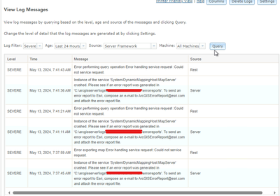

We are facing the below severe error logs on ArcGIS Server.
Trying to understand what could be triggering this or is there some ways to minimize/fix these errors?
Any help on this would be highly appreciated.
JakeSkinner
Esri Esteemed Contributor
Hi @Yogesh_Chavan, are you services configured with Shared or Dedicated instances?
I've seen this error before when all services are configured with Shared.  Try changing the services to Dedicated.

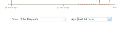

@DougBrowning I highly recommend heavily used services to be set to Dedicated.  For the number of instances, there is no default answer.  I would recommend starting at a min of 1 and a max of 4.  Let the service receive requests for a some time (i.e. half day/full day) and take a look in ArcGIS Server Manager > Logs > Statistics.  You can view the number of requests that particular service is receiving.
Check the Average Response Time statistic for the service.
I typically recommend keeping the response to 2 seconds or less.  If you see excessive times, check the Service Maximum Running  Instances for the service:
If the Max Running Instances are maxed out (i.e. 4 instances) this is indicating clients are waiting for a instance to handle their requests, which means you should increase the max instances for this service.

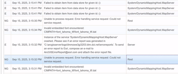

I started changing our services to dedicated, 1 and 4 as you said and its much better.  But we still are getting this error in the log a lot.  Even with only 1 user and 1 out of 4 instances we get it.
Failed to obtain item from data store for given id: ()
Happening on pretty much every service we try.  We double checked, republished, etc but it just keeps coming up.  Is it a managed data store config issue maybe?  We have a lose admin team right now and hard to tell who setup what and if its correct.  Portal is 11.3.
Posts like https://community.esri.com/t5/publishing-and-managing-services-questions/arcgis-server-log-severe-qu...  point to a resources thing but we are only using 1 of 4.  Is it resources or some other data store issue?  The SDE this all connects to is super fast and no issues there.
Thanks a lot we are going a bit nuts here!
Scott-Shavnore
@DougBrowning which version of ArcGIS Pro are you publishing the layers from? You mentioned Portal/Federated Server is 11.3, so thinking you may be at ArcGIS Pro 3.3 but do you have any minor version patches installed? If publishing from Pro 3.3.5, you could be encountering this bug https://support.esri.com/en-us/bug/publishing-from-arcgis-pro-335-to-arcgis-enterprise-suc-bug-00017...
It was recently reported as fixed in Pro 3.3.7, I plan to begin testing this to see if it resolves the same issue in our environment.
