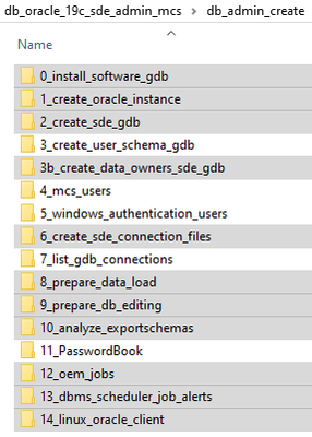

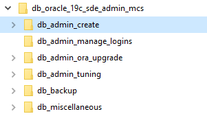

In your scripts  there is a folder called db_admin_create (plus others) and best pratices book contain other scripts. Also sometime there are different database version scripts.
Could you indicate in which order these steps should be performed and what the reference is for (book or scripts and which script)?

Oracle 19c Database Template Scripts
ArcGIS Pro 3.x & ArcMap 10.9.x June 21, 2022 *New
if you unzip you will see that the folders are ordered by number 1, 2, 3, ... hence follow the order to setup the Oracle database and then create the ArcSDE Repository and continue to follow the scripts to complete the Oracle database configuration.
The steps in the database guide book are included in the database template scripts, but the database template scripts cover a lot more detail and advanced Oracle features and the person needs to be an Oracle DBA to understand the database template scripts properly.
