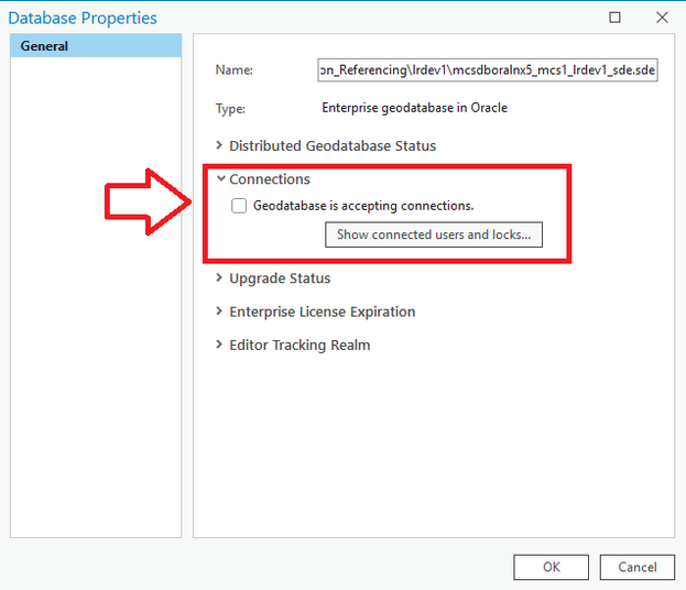

6. Active Connections
Make sure all user connections are closed.
Tip: ArcGIS Pro > Right Click Geodatabase Connection File for the "sde" user > Properties > Database Properties > Connections > Show connected user and locks...
This includes ArcMap, ArcCatalog and ArcGIS Pro.
You will need to ask users to close the applications and/or have the Oracle Database Administrator to kill the user connections.
Also, stop all ArcGIS Server Services that connect to the Enterprise Geodatabase.
Tip: when you open ArcCatalog or ArcGIS Pro to perform the Geodatabase Repository Upgrade make sure to click only on the Geodatabase Connection File for the "sde" user, if you click on any other connection file (e.g. data owner user, editor/viewer users) then you create a geodatabase lock that will prevent the upgrade to proceed, you must close ArcCatalog or ArcGIS Pro and re-open, only the "sde" user can perform the upgrade.
After all users and services connections are closed  you can disable geodatabase connections to prevent any new connections to the geodatabase, of course only the "sde" user is allowed to connect.
Tip: ArcGIS Pro > Right Click Geodatabase Connection File for the "sde" user > Properties > Database Properties > Connections > turn off "Geodatabase is accepting connections" > Click Ok

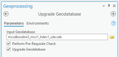

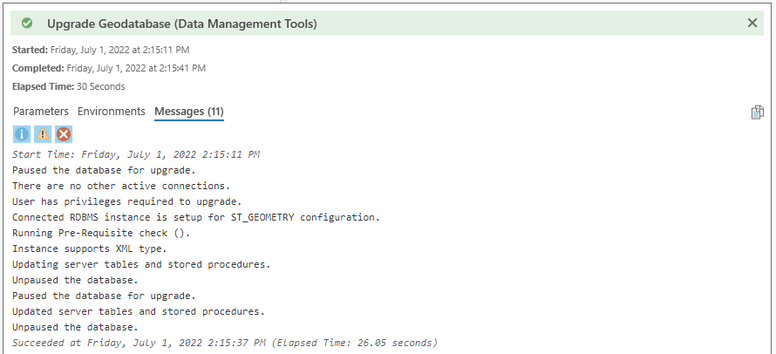

7. Upgrade Geodatabase Repository
Follow the steps described in the documentation to upgrade the geodatabase repository.
Upgrade a geodatabase in Oracle
Use the Upgrade Geodatabase Geoprocessing tool
Upgrade Geodatabase (Data Management)

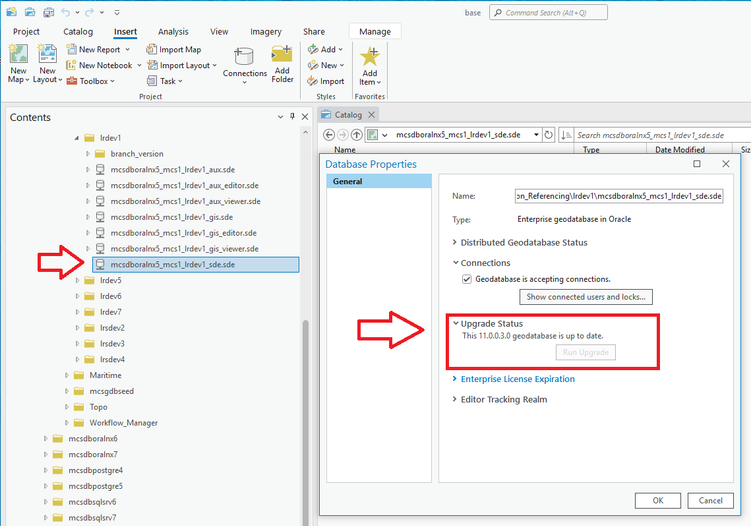

Right Click Geodatabase Connection File for the "sde" user > Properties > Database Properties > Upgrade Status
Tip: if you turned off the option "Geodatabase is accepting connections", then after the upgrade the option is turned on automatically
ArcGIS Pro > Right Click Geodatabase Connection File for the "sde" user > Properties > Database Properties > Connections > "Geodatabase is accepting connections" >
