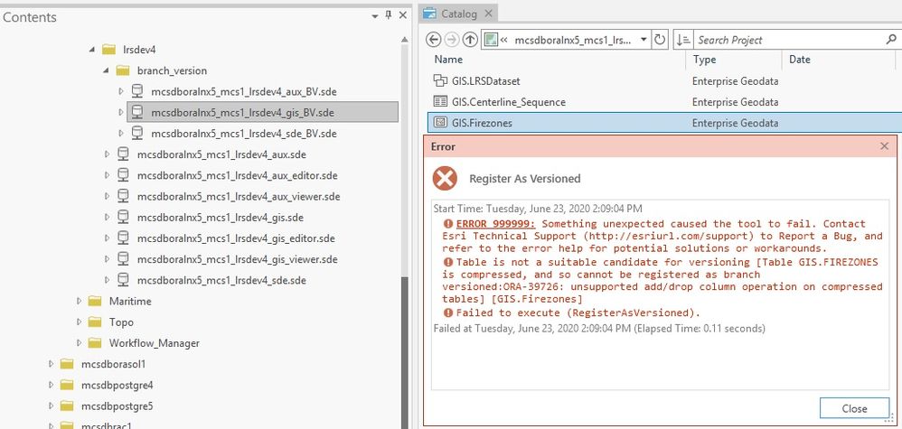

5. If try to enable Branch Version (aka. Register as Version) the Featureclass then it is expected to fail because the table is compressed
Pro Error Message " Table is not suitable candidate for versioning [Table GIS.FIREZONES is compressed, and so cannot be registered as branch versioned : ORA-39726: unsupported add/drop column operation on compressed tables]"
  • we cannot register the data as branch version if the table has Oracle Compression enabled
  • branch version needs to create an Oracle Identity Field, and a column with Oracle Identity Field Type cannot be added when the table has Oracle Compression enabled

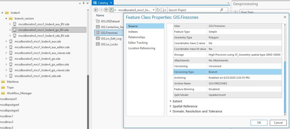

10. Pro enable Branch Version (aka Register as Versioned) for the featureclass works fine this time because table is decompressed

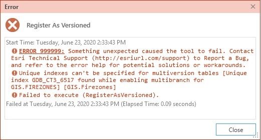

17. Pro try to enable Branch Version (aka Register as Versioned) fails with message
Pro Error Message "Unique indexes cannot be specified for multiversion tables [Unique index GDB_CT3_6517 found while enabling multibranch for GIS.FIREZONES]"
the featureclass got to a state that cannot re-enable Branch Version.
if delete the unique indexes in the featureclass then get other ORA-xxxx errors, it never fixes the problem manually.
