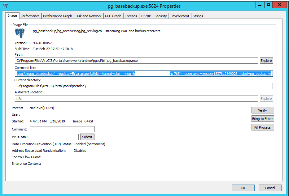

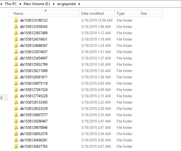

I'm seeing an issue in HDD space with a 10.6.1 HA enterprise environment in which daily around ~15Gb worth of the primary portals db folder gets backed up every 6 minutes to the local portal drive on each server.
It seems that the pg_basebackup.exe is creating a backup of the primary portal on each of the machines rather quickly, and once full, the portal grinds to a halt and both of the portals are no longer contactable (even the portal with available hard drive space does not appear operational)

On the primary machine in an HA configuration, the dbXXXX folder is created during a restore. On standby, it's created when the machine is coming back from a failure. Other than that, it shouldn't be getting created on primary. The only situation I'm aware of that will continually create dbXXXX folders on standby is the presence of the promote.dat file within the db directory on the primary machine. Can you see if that file is there and if it is, delete it? It'll create one more dbXXXX folder on standby but should be stable after that.
Can you check the logs and see if there are any indications as to why it's creating the db snapshots on the machines?

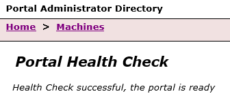

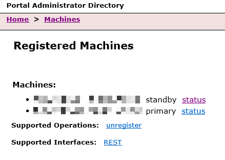

One thing I'm not sure of is whether the standby machine is successfully acting as the standby server, even though it seems to be reporting as so in portaladmin :
With both reporting as:

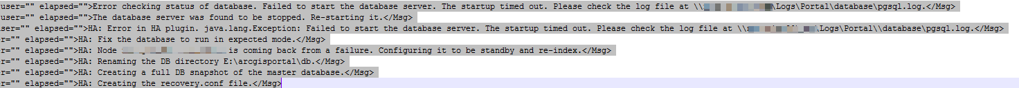

I am seeing the following error on the standby machine in the portal logs:
The pgsql.log list only the following:
And on closer inspection there are no postgres.exe services running on the standby which makes it seem it's not "recovered" properly.

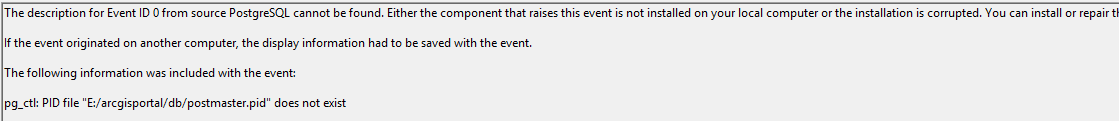

Check the Event Viewer. When you see "database startup timed out" type errors, that means that the database isn't starting correctly and the only place the cause is logged is in the Event Viewer. You'll see a bunch of errors in there, but there will be one that tells you why the database can't start.
DeanMoiler
Hi Jonathan,

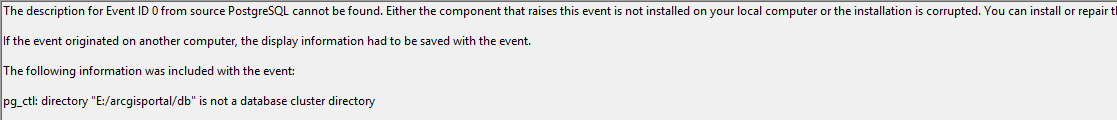

I've taken a look and can find several references to the DB not starting correctly in the server event logs:
I've tried copying the postmaster.pid from the production system, but then get the following error appearing in the logs:
as the 17200 value in the PID file seems to relate to the postgres.exe process on the primary machine.

The important error is the "not a database cluster directory" error. What are the contents of the latest dbxxxx folder? Do they match the contents of the db folder on the primary machine?
What's likely happening is that the standby is detecting that the database is not running so it thinks it's coming back from a failure and gets a new DB snapshot. The standby can't start the DB again, (due to the not a database cluster directory error), and then again, it thinks it's coming back from a failure because the database isn't running. That's likely the loop it's stuck in. Figuring out what the PG doesn't like about the db directory is the first step by looking at the contents.

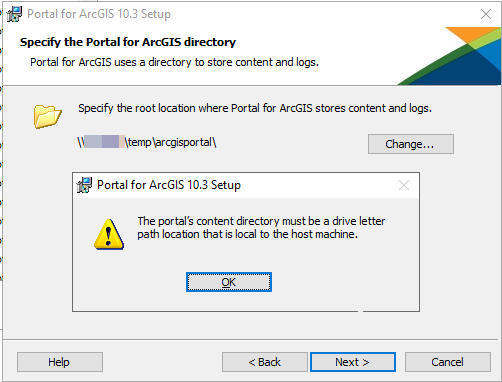

FYI sounds like you're aware of this now, but the initial arcgisportal directory, (the path defined during the setup) must be a local path. This defines the path for the logs, index, temp, and most importantly, the database directories. We've been validating that the directory is not a share since 10.3:
Can you describe how you configured the logs for the database to be under the share? I think the only way to update the log path after the portal is created is by modifying the DB config files manually.
