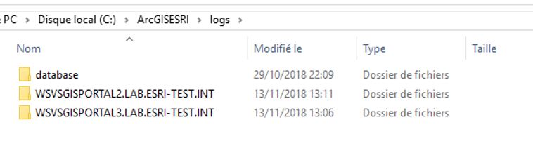

Yes you are right. I configured my portal and I changed the directory throught portaladmin interface. Then I had three folders in my shared log folder (as shown in the figure):
As I told you that I completely missed this point. As soon as I configured the log directory towards a local path D:\arcgisportal\logs. The problem was solved.

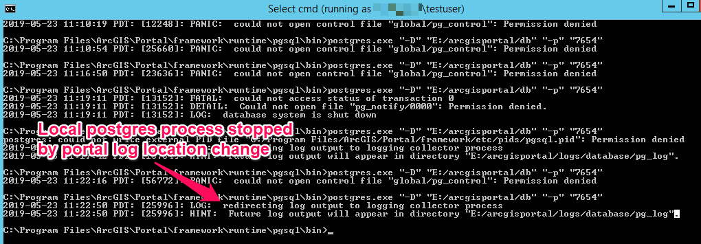

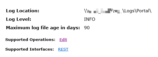

thank you so much for your insights, as soon as you said that I had a feeling that it just had to be exactly that as I had been streamlining both test and production environments to utilise common application, widget, logs and backup locations and as you say you can update the logs to a shared folder for which I had not anticipated such a catastrophe, as it's the log files and not the applications themselves and the admin portal allows you to change it:
Once I amended the log path back to the local directory in Portal Admin the postgres.exe that I was running with a local testuser account on the failover server stopped and the postgres.exe services started running with the correct service account:
Failover Server:
Both portals are now up and running as they should be.
