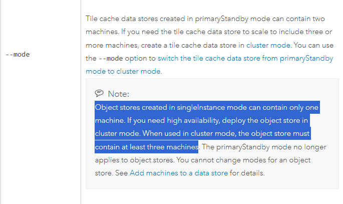

I have doubts about deploying an object datastore in a high availability configuration, which consists of two machines. Which mode do I need to select, SingleInstance or cluster? As per the documentation, I am pretty clear that the mode can't be the SingleInstance for cluster mode; the documentation says that -
For SingleInstance mode only one machine is required and for cluster mode at least three machines are required but if we have only two machines for object datastore then which mode I need to select.

It's not possible to configure the Object Store on just two machines.  You will need cluster mode and three machines for a proper HA configuration.  While you could do a single instance mode and install on one of the Data Store servers I would not suggest it, as it would not be HA and the mode cannot be changed after the initial configuration.

- There is only singleInstance and Cluster mode.
-- For High Availability, Cluster mode is required
-- Cluster Mode requires 3* machines at minimum (*odd numbers only)! (opposed to the Tile Cache which only required 2 machines for HA)

@SimonSchütte_ct You're welcome!  I don't know if it is helpful, but for reference this is documented in the Architecture Center.
