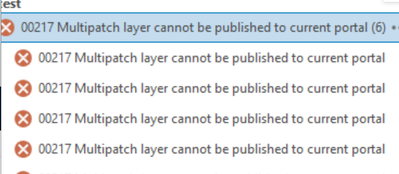

I tried to omit the above properties and provided a "path": "/cloudStores/S3_dev_ght34362ss" where ght34362ss is a random string and tried to register item. It returned success but I cannot publish any scene layer. It gives this error:

And I still get "00217: Multipatch layer cannot be published to current portal" errors when publishing a 3D scene to ArcGIS Portal.

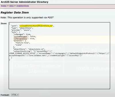

"If I have Amazon S3 Cloud Store, do I still need ArcGIS Data Store Object Store? Documentation suggests I do not." -> No, you are right. (ArcGIS Enterprise: Migrate to the object store)
I found an actual example:
https://youtu.be/2TJNpyxlnyA?feature=shared&t=1128
What does /server/admin/data/items/cloudStores/S3_dev_ght34362ss?f=pjson return?
