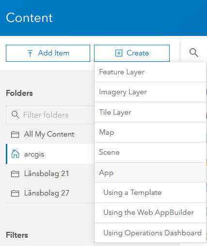

I have ArcGIS Enterprise 10.7.1 installed. It's an single machine deployment with ArcGIS Server federated and choosen as hosting server. It was an test-enivorment with test-licenses until last week. Updated with buissness licenses and everything checked green. However when I try create new feature layer in portal there are no options for that;
It suppose to look like this;
My user i admin and creator.
Any ideas on whats wrong?

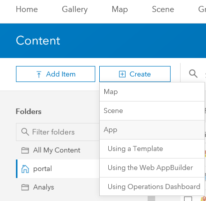

Can confirm this literally just happened on my portal as well. Federated 10.7.1 with datastore. Uploaded several hosted layers. Everything was working fine. One of the hosted layers became totally unresponsive and unuasable last night. Decided to create a new duplicate layer to test. Publishing failed. Attempted to create a very simple point layer through the create content utility in portal. Here are my options:
Any help would be appreciated. I also recently updated my license but also did the updatelicense.bat. I also recently installed the patch for 10.7.1 but the problems did not start immediately. The first notice of issues was after I published a hosted feature layer. The service checked out ok after publishing and I ran a few tests with it. While trying to set the extent through the settings page the service became totally unresponsive.

I think you were right. I hope you get this message before you get too far along. I looked deeper at the http requests and found that there were a few calls to https://machine_name.subdomain.domain.com:6443/arcgis . I'm pretty sure that using the FQDN for service URL's was the documented workflow for federating the server and setting up the web adaptors but it seemed to be the source of the errors in my case.
Reaching the site from web was done by going to the "short name" (https://machine_name.domain.com) and the SSL cert was issued in the same format. We were forcing HTTPS not only through portal but also through the webadaptor. Bindings were only configured for port 443 and there was no SSL cert for the FQDN.
Now that I'm typing this up I did remember reading somewhere that portal and server need to be able to communicate through port 80 (on the back end). I just realized I probably could have added an HTTP binding to port 80 in IIS, but since we had 6 maps, 10 hosted feature layers, and fresh backups/snapshots of everything I chose to:
  1. update the host file entry with the "short name"
  2. un-federate the server
  3. uninstall web adaptor
  4. reinstall web adaptor referencing "short name"
  5. re-federate server using the "short name"
Everything has been working great but before you go breaking federation just realize that there are consequences. Usually you break the link between the maps and the layers (but that can be fixed with AGO Assistant) but in our case it created replicas of the hosted feature layers that either had to be synchronized or downloaded and republished.
If I were you I would test the port 80 binding first (which is what I probably should have done) before you consider breaking federation. If you go the repair through AGO Assistant route just be warned you will get no support for the tool through basic support channels. It's kind of a high level tool and and can break lots of things if you use it wrong. Make sure to make backups and take snapshots!
