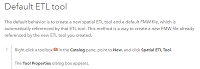

Hello, i'm trying to create my first Spatial ETL tool and i'm having trouble with an early step in the documentation. I'm not seeing Spatial ETL Tool as an option. I do have a license checked out. Anything else i'm missing?

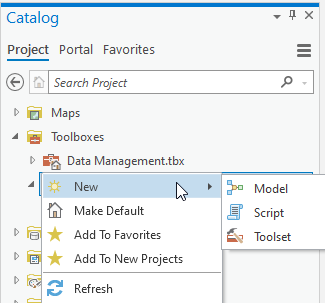

This is what i'm seeing after creating a toolset
and i'm seeing the same when right clicking a toolbox and selecting new.

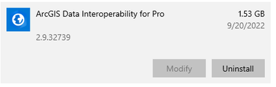

Are your Pro and Data Interoperability installations at the same release?  I see an atbx in your project but 2.9 for Data Interoperability.
ChazArmijo
it looks like my pro installation is behind my DI installation. I'll see what i can do to align them. Thanks!

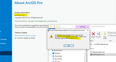

I am on Pro 3.0.3 and my Organization provided the Data Interoperability installer for 3.0, but i get an error in the install. Do I need another version of the Data Interop installer?
Update: I got the 3.0.3 installer from my Org. woot!
