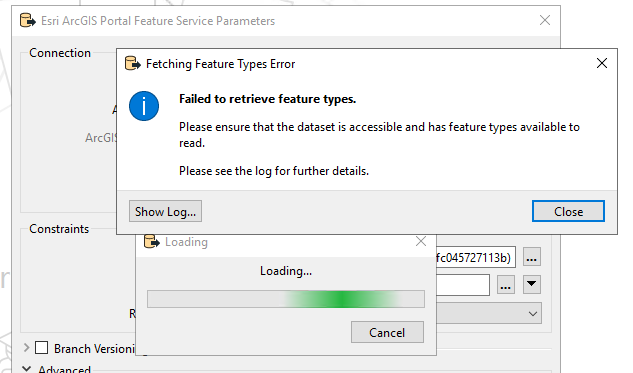

I had a scheduled data interoperability tool that created a feature class from a table created from a Survey123. The survey 123 table was not a point layer - just a table. It did have an x and y field which allowed me to create the table. I needed to create a spatial layer for use in a dashboard and to allow exporting data. This was working fine until about 6 weeks ago. I am no longer able to read from a table. If I try to connect to the feature layer which contains 2 point layers and the table - I can only see the point layers. I tried making a view layer of the table only - but get the following message "Failed to retrieve feature types"
This was working for a few months. We have upgraded Enterprise versions, however I am fairly sure the script stopped working prior to the upgrade.

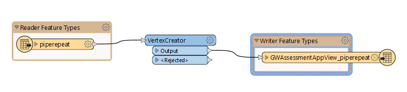

Below is the tool that was working (Reader no longer reading the table)

This bug was reported as a regression in Pro 3.0.  Safe provided the fix and it will be available for Pro 3.1. Support should have additional details on this bug.
Here’s a link  from Safe on this bug and the reference to the fix for the FME Engine
https://community.safe.com/s/question/0D54Q00009Zd3FdSAJ/fme-desktop-update-2022-no-longer-see-table...

John, re-authenticate your portal web service connection, in Workbench go to the Tools>FME Options>Web Connections dialog and right click in your portal connection, you'll get a context menu.  It can happen the refresh token doesn't work if unattended for a period of time.  If your tool still fails then open a support call.  I just created a standalone table in an Enterprise 11.0 portal and the reader worked.
