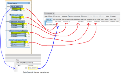

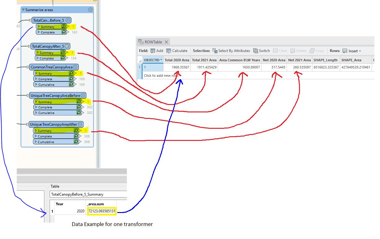

Hello All. So my question is how do I take the results of several different transformers, and then write the results back to a single arcgis feature? I would basically like to field map the result value from the transformers to specific columns in the feature class table. Screenshot below.

Hi, the simplest approach is to use an Aggregator and merging existing attributes, you will get one feature with all the attributes available on the input features.
