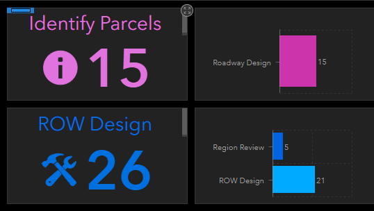

Hi, I am using the serial chart widget in a dashboard and while it is easy to bring in values of existing features, I want to show all in my domain, even if it is blank. That might not make sense.I'll try to include a screenshot.
In my two serial charts on the right, for the above one, I want to show the 'roadway design' and another bar, but that other bar needs to have zero (0) for its value. Same for the bottom chart - I want to add one more attribute with a zero value so users will know it's there. Is that possible?
It seems that I can add as many categories as I want but it the category has zero features, then it won't show. Am I missing a check box somewhere that says "show even if it has zero features"?

If the attribute table does not have any data, then the serial chart can't display a "zero" value. Sorry.

I've double checked with the Dev team and unfortunately, there isn't a workaround for what you want to render in the chart. Sorry. The charts in dashboard only show categories that have a non-zero value. Please submit an enhancement request on the ArcGIS Ideas site for ArcGIS Dashboards.
