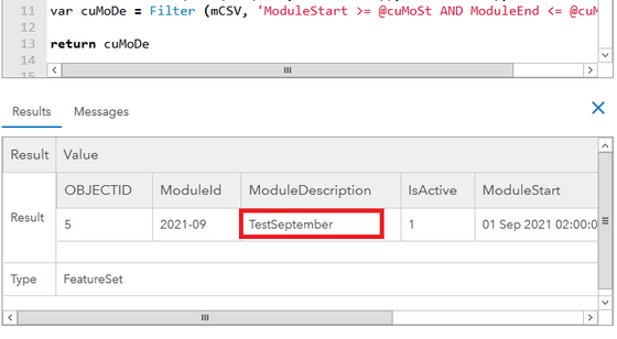

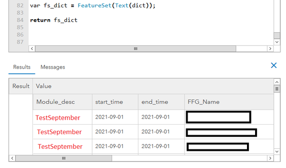

Hi there,
I appear to have lost my way in a seemingly easy task. I would like to copy a certain value (TestSeptember) from one feature set to a new one:
Edit: the FFG_Name is blank due to data privacy (contains names).

JohannesLindner
MVP Alum
// before line 40
var module_desc = null
if(Count(cuMoDe) > 0) {
  module_desc = First(cuMoDe).ModuleDescription
// before line 44
'Module_desc': module_desc,
Have a great day!
Johannes

Merlin
Hi David,
The FFG_Name field was blank to hide the names that actually show up.
My goal is to copy the ModuleDescription Field containing the string 'TestSeptember' to all rows of the second fs.

Merlin
Excellent! Cheers Johannes.
This was the function that did all I needed:
