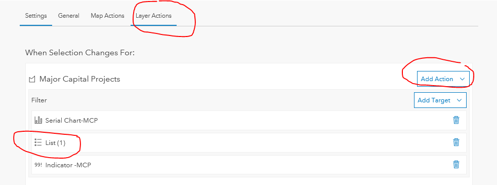

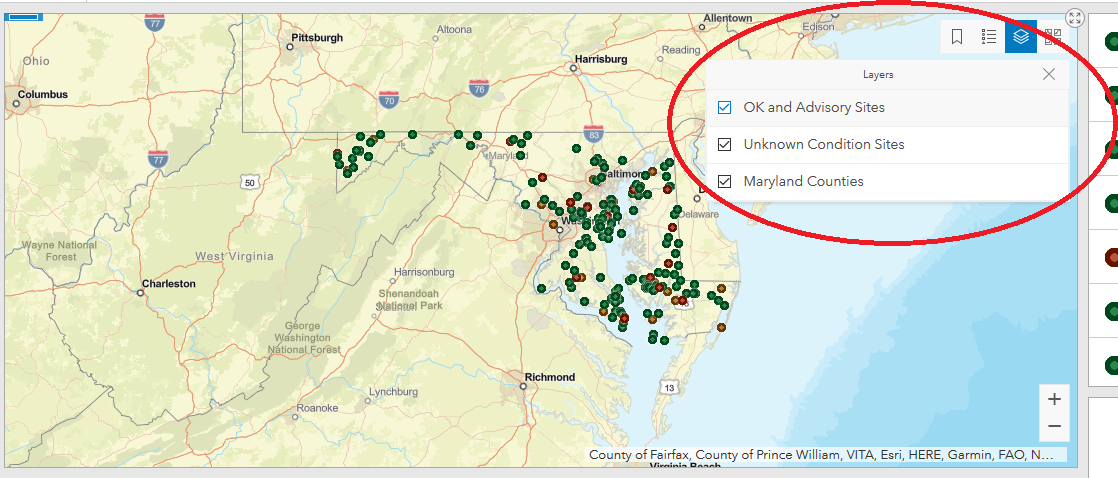

Not sure where I am going wrong or is my understanding wrong.
What does the Map -> Layer Actions do?
I have a map with a indicator attached to the layer. When I switch off the layer, I want the corresponding "Indicator" to go blank. Is that possible?
What do you mean by "switch off the layer"? Do you mean, when you uncheck the layer in the Layer Visibility tool in the Map element?
If yes, then no - this is not a supported workflow in Operations Dashboard.

JosephJose
Thanks Derek. That answered my questions.
Just for the knowledge  part
What does the "Layer Actions" tab do? I seem to miss the documentation on that front. Perhaps some words in your own would be helpful.
Can I assume that items in the tab are still in beta?
"Layer Actions" are interactions that you can set on layers within the web map. For example, if you were to select a feature on a layer in the Map element, it could apply a filter to a target element in the Dashboard. Please see the Operational Layer section in the help topic I referenced previously.
No, the items on the "Layer Actions" are not beta - they should be working fine and as designed.
