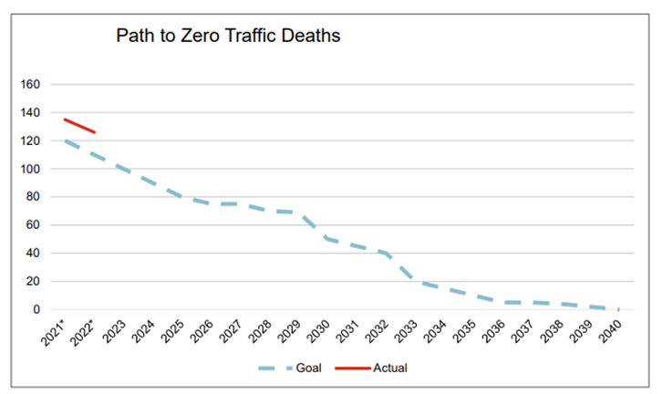

I need to create a line chart with two lines: one with actual numbers and another one that represents a downward trend to 0.  Like this:

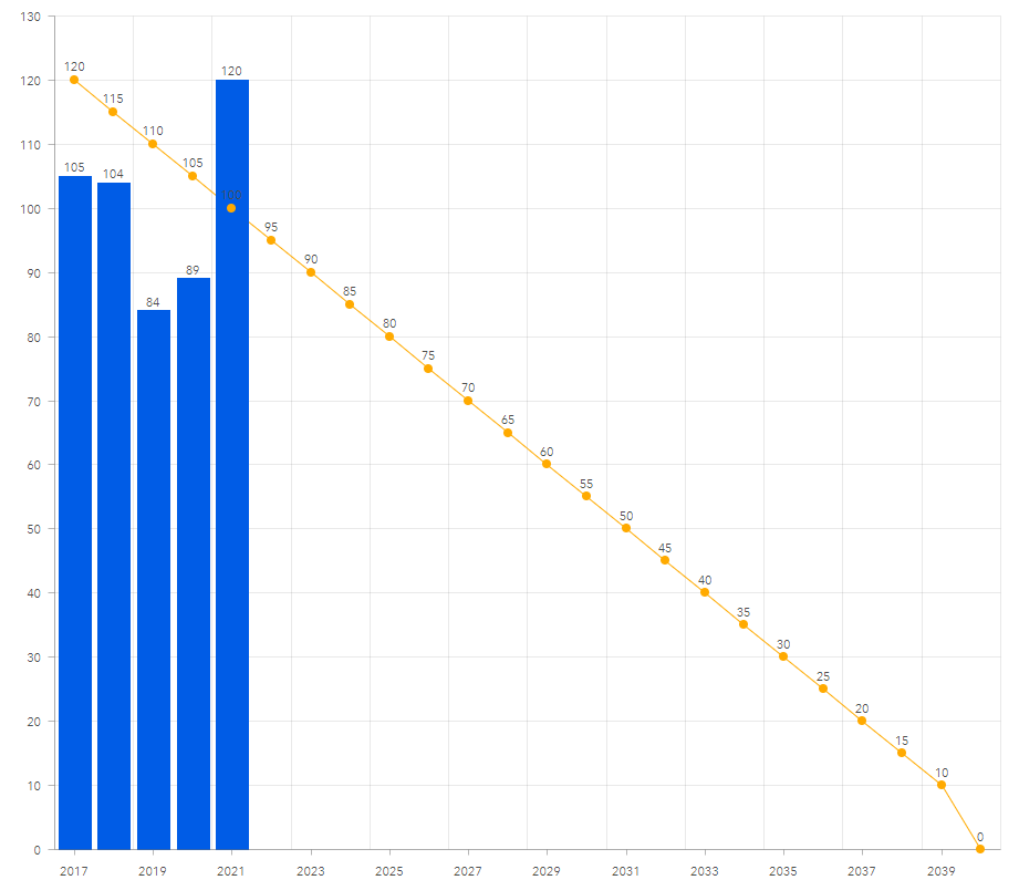

Dashboard has the option of converting bar charts to line but is there a way to show two different lines? instead of one bar and one line, like below

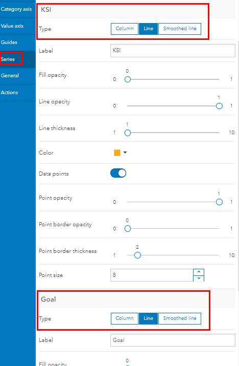

Thanks Josh! but I figured it out. I just needed to update the "Series" tab for the actual value from column type to line 😅
