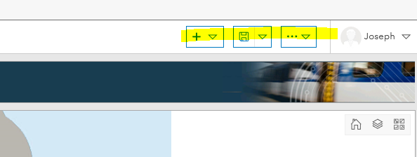

JosephJose
The setting button isn't visible for me. Screenshot below
StephenM
That's odd. Maybe it has something to do with the version. Are you using ArcGIS Online or Enterprise?
JosephJose
Portal 10.5.1
Whom should I be approaching to rectify this?
StephenM
Ah, version is likely why that setting isn't available. The link I posted is for the web-based Operations Dashboard for ArcGIS Online and Enterprise 10.6+. The number prefixes setting was introduced last year:
