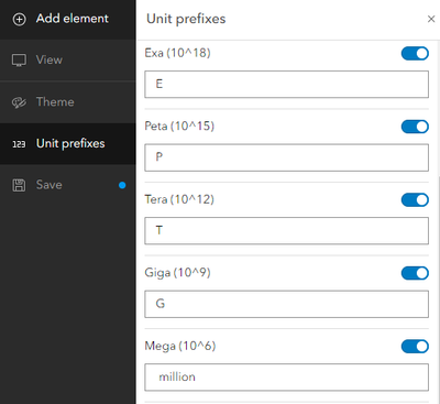

ChelseaRozek
MVP Regular Contributor
In case anyone is looking for it in the new dashboards, it's here:
