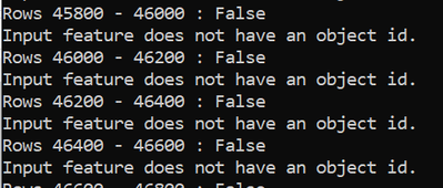

LouieRodriguez
Hi Josh,
I tried implementing this code into my script and wasn't able to get it to work so I was wondering if you have ever seen this error before or know where I can read more on the subject.
The script that ran was looking to add 200~ records to a 50,000 record csv of data and this is the message I got for every group of 200 records. The issue must come from the .truncate() or appending feature but I am not sure why I get the object id message. When I got to the feature layer after, it is completely blank but not corrupt.
jcarlson
MVP Alum
Major facepalm moment. It should be
lyr.edit_features(adds=fs)
msg = updt['addResults'][0]
It was trying to update existing features, using an object ID to do so, but your FeatureSet wouldn't have any object ID, hence the error. Try it with the modifications above.
- Josh Carlson
Kendall County GIS
