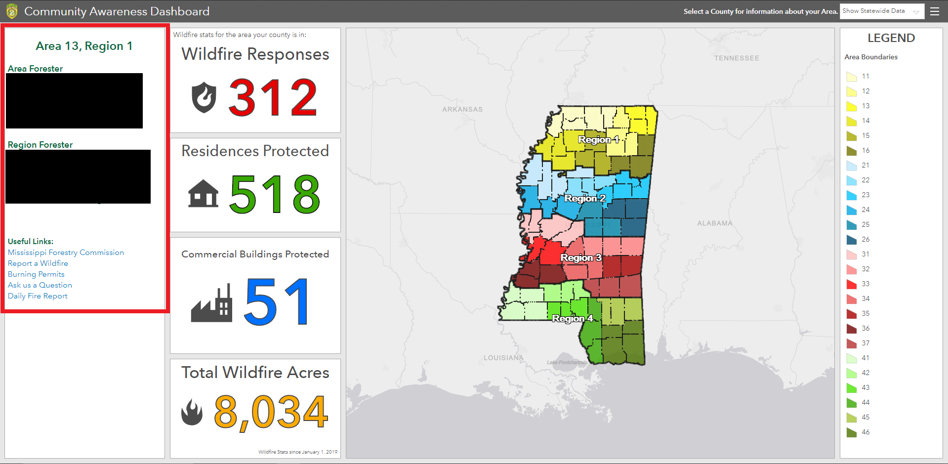

In my info widget of my app (in the web version of WAB as well as the Developer version) I can change the text. But I don't seem to be able to add an image to the text when using Chrome: it does not bring the window to select a picture. Edge does the same. In Firefox and SeaMonkey it takes a while but then the window opens and I can select and add a picture.
Can somebody reproduce this behaviour?
