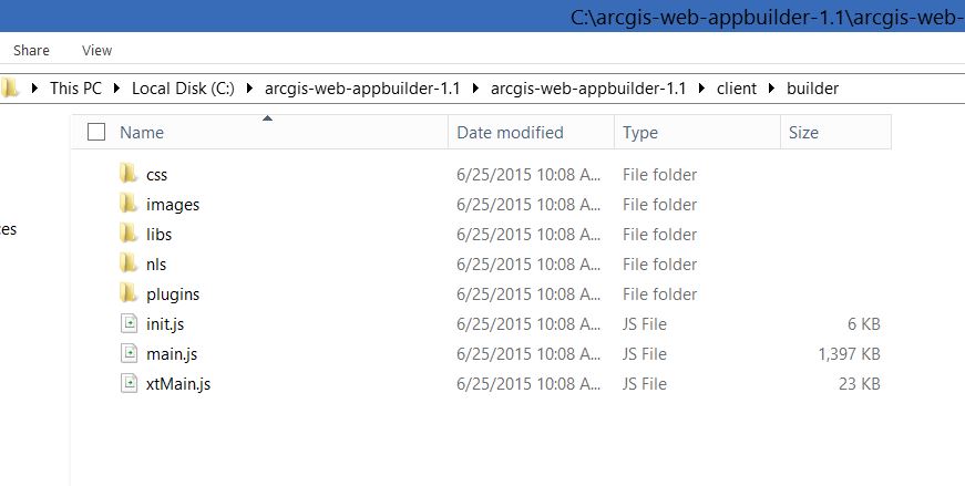

1. There is no \client\builder\predefined-apps\default2DApp\ folder.  I did find a config.json file in client\stemapp\predefined-apps\default so I added the code to this file.

I did all of this and read through the document.  Do you have that default2D folder in your directory?
This is where I found the config...since there was no pre-defined apps folder in my other location:
DanielStoelb
I do not have the default2D folder.
