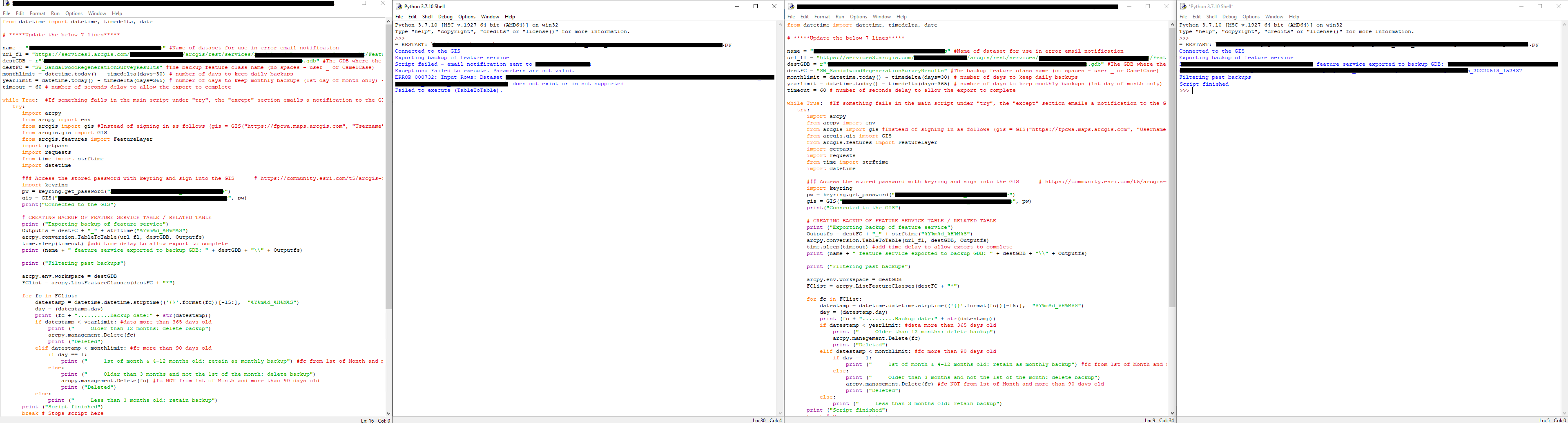

Hi brains trust. I need a bit of support here. I have a python script that accesses an ArcOnline feature service and downloads the data, saving it as a feature class in a local (network) GDB. I know the script works as I have it running on one PC, but on another, despite running it in the same software (IDLE for ArcGIS Pro) it fails. The error is that the parameters are not valid and the input dataset does not exist or is not supported. This is despite the same login credentials for ArcOnline being used. I'm at a loss as to why it won't work. It works fine for all my other scripts which are point/line/polygon feature services. The only difference is this one is a related table for a line feature service. The image below shows the same script and the results (left screen is the failure on the remote PC - right screen is on my PC).

Hi Linsday  - it's really hard to read your code when it is posted that way - this article describes a better way. I would start by dumping out all of the paths that are referenced on the failing PC an simply see if I can access them from a DOS Command window.  In particular I would look at the paths in the related tables properties (et. the origin and destinations). Another idea is to try it from a 3rd PC and see it it works there.

Sorry for the dodgy code sample - I normally do include a proper code sample instead of just screenshots. I suppose I was just trying to demonstrate that both were the same but showed different outcomes. Will make sure I include the code sample as well next time! I've also included a code sample above.

Is your DestGDB located on that remote computer at all? If so, is it on a network drive with a different name?

I've included the sample code above now. The output GDB is on a network folder (directly mapped - not using a drive letter).

I've seen issues with the keyring, where the Credentials Manager in Windows has corrupted the profiles.
Opening an GIS connection is successful, but you are not being authenticated as the user you think you are. It ends up making an anonymous connection instead. This would explain the failure to find the service resources.
You may need open the Credentials Manager from the Control Panel and drop the accounts, then use the Python API GIS connection object to recreate the Profile with the stored credentials.

Hi. Interesting. I did use a code sample to use keyring to store the credentials in the first place - is this what you are referring to? I might try updating the details again anyway and see if I get a different outcome.

I tried removing the credentials and resaving them (using the below code) but it made no difference.
