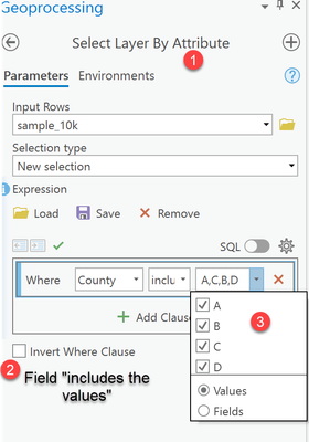

Not sure but it appears that a select by attributes to get all values would be simplest, then a single select by location which will use the subset of the first step.
doing it manually,
but once that set is selected all you are doing with the spatial join and assigning all those that meet the spatial condition the same value.
