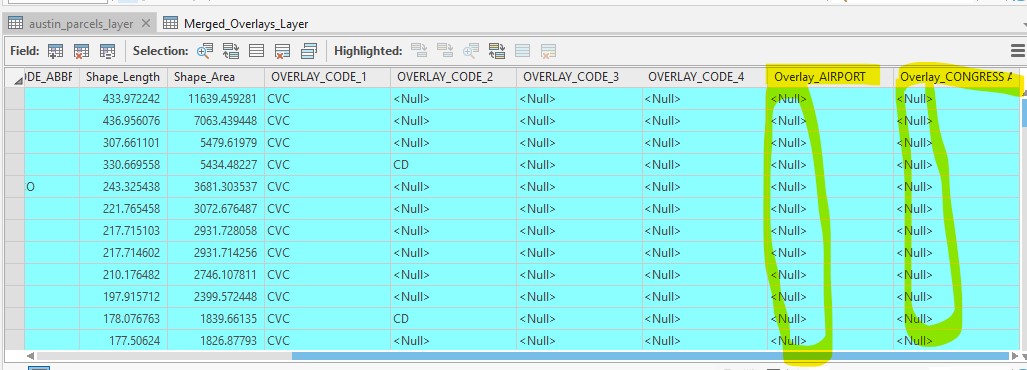

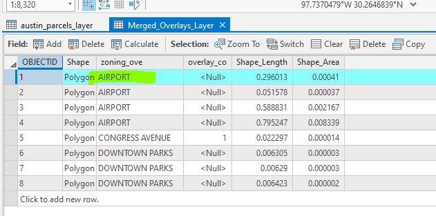

My goal is to:
Copy the text from the selected feature below:
and put it into the newly created field.
I would really appreciate your help,
Thank you so much!
Natalia

NataliaGutierrez1
Hi Joshua, Randy and David,
Thanks for your help!
I did need to add a new field for each loop in the Search Cursor.
This is the code that ended up working. I am sharing it just in case anyone needs it.
I had to fix some of the raw data for it to work correctly. I had to modify the names of the cell values to have underscores instead of spaces.
