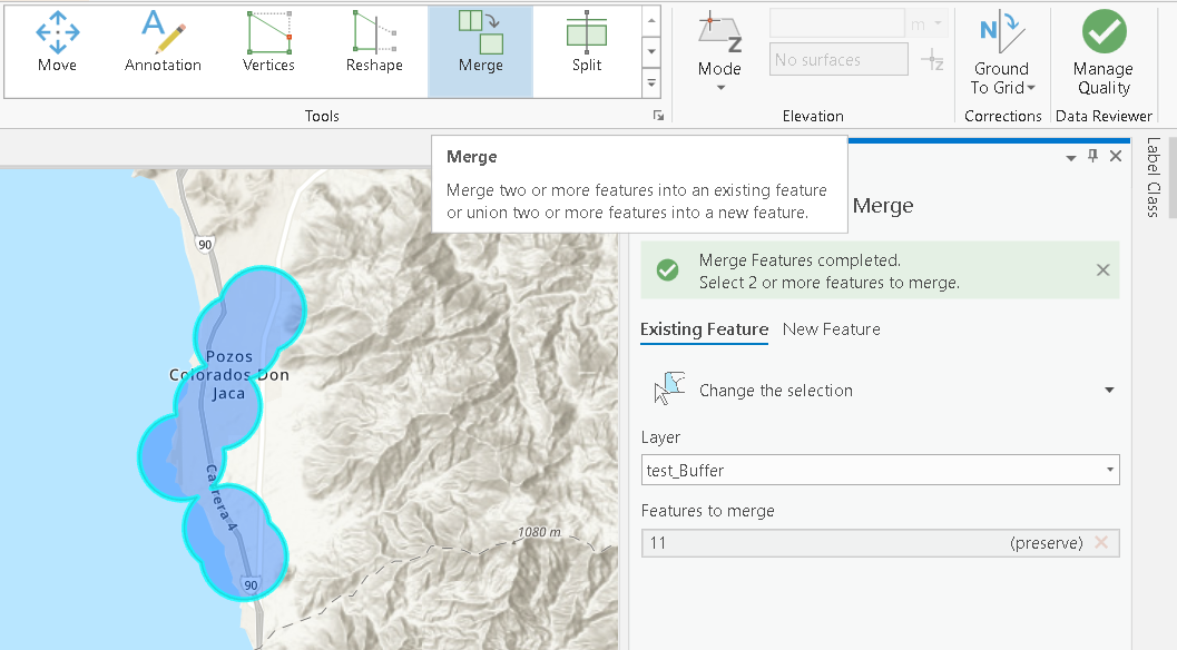

During an editing session in Pro, you can select multiple polygon features and merge them:
...resulting in a single feature:
Is this what you are looking for?
2Quiker
yes i can do it on pro, i am trying to do it in a python script.
