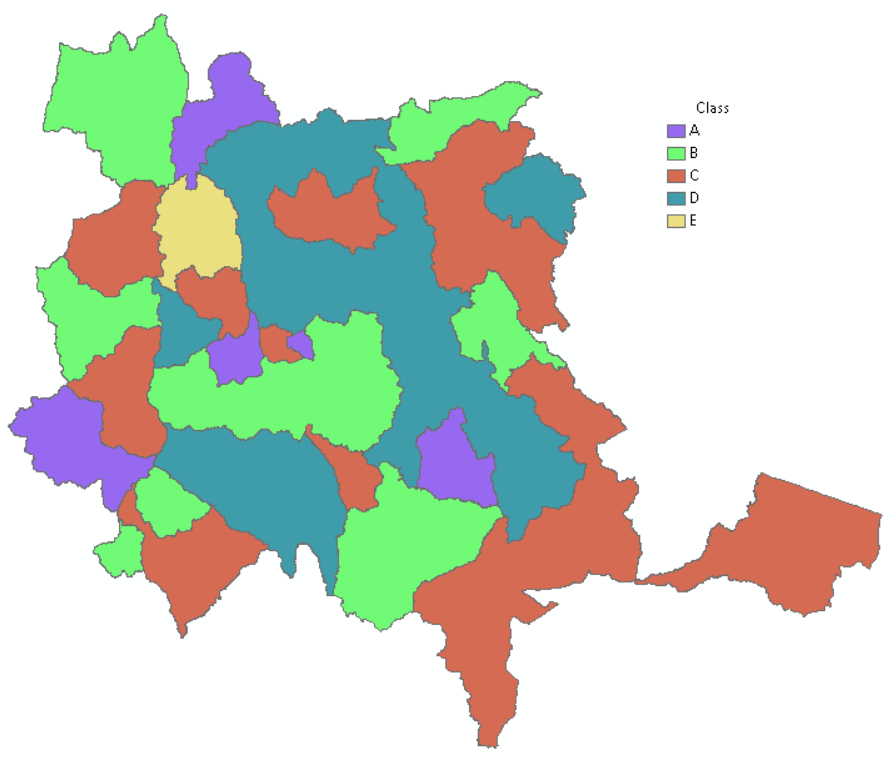

Input polygons for testing:

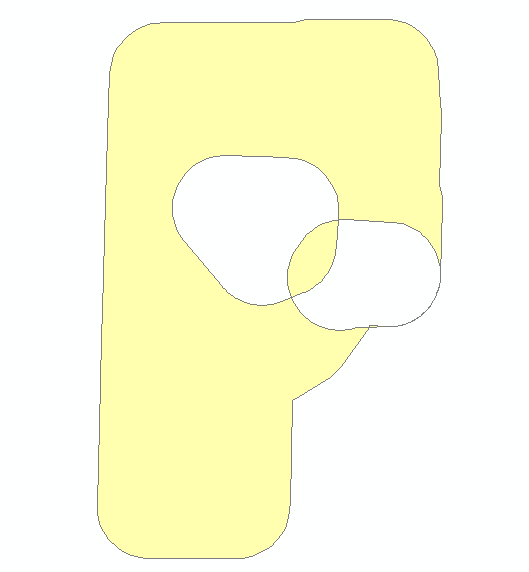

resulting polygons:

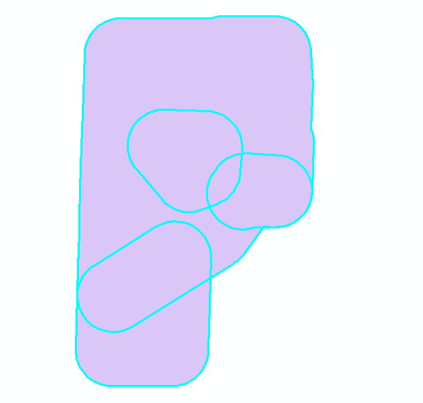

2Quiker
Xander,
Thanks for the reply and code, after running your example i noticed that the result is the same as my script. I thought i posted pics of my code results but i guess i didn't. It seems as both your and my code cuts out the over lapping polygons. I forgot to mention that there are some over lapping poygons.

Can you change the function "DissolveGeoms" for this one below and try again (on a copy of your data)?:
def DissolveGeoms(geoms):
    cnt = 0
    for geom in geoms:
        cnt += 1
        if cnt == 1:
            diss_geom = geom
        else:
            diss_geom = diss_geom.union(geom)
    return diss_geom‍‍‍‍‍‍‍‍‍
2Quiker
Xander that worked thank you for sharing!
