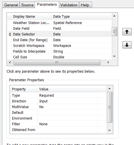

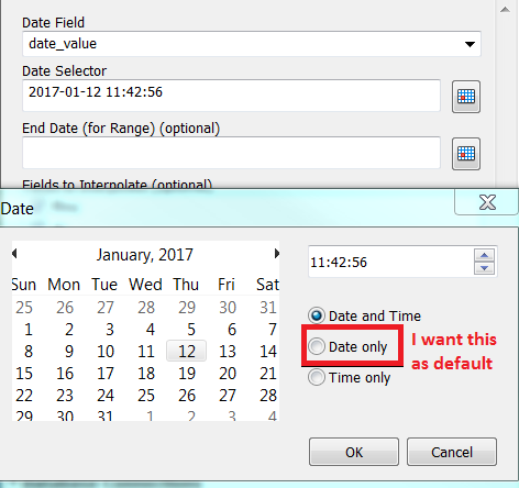

I have written a script and have an arcpy tool in a custom toolbox to fill in the parameters.
Two of my parameters are dates.
The Date data-type format for the parameters has a default setting of date and time format to the script.
I'd like to only pass the date onto my script.  I included some screenshots of my parameters and the date data-type in the tool.

I found some interesting things with the Date data type:
  1.  Even if you select date only radio button the parameter still 'holds' the time.  It will be set to 00:00:00, but does not get passed onto your arcpy script though.
  2. If you select Time only, the date is still stored in the parameter.  It is set to 1899-12-30.  But it too will not be passed onto your arpcy script.
  3. If you program in the validation code to strip out the time, the radio button changes automatically.
I found those funny things with the date/time because I wanted to send an error if a Time type was entered.  The validation always returned true when looking for time, even when there was only a date in my parameter.
