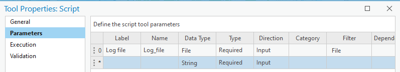

I'd like to assign path to some file (let's say it's a log file) in a script tool as a parameter. This file may already exist (some information might have been written and I don't want to lose it) or may not (then I want to create it).
Now - if I set Direction to Input in Tool Properties  -> Parameters - then it is only possible to point to existing file (it won't allow me to create a new name). If I set Direction to Output then I can create new file, but if I point to old one, it will automatically overwrite it (not what I want as I want to retain the contents of the file)
Is there any smart way to make the tool parameter to behave the way I want?

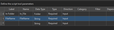

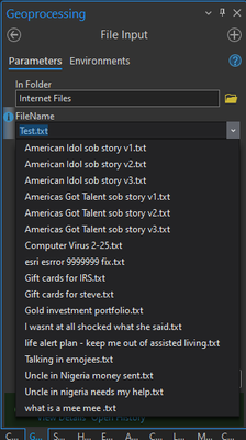

Ok, sure. Didn't know that the Folder/File dialog was a requirement but with that, get the folder first using the Folder Datatype, then list the files for folder selected through the ToolValidator class. The user can select one from the list if it does exists or type in a file name if it doesn't exist. New files will have to be typed in- how would you select something that doesn't exist? You can include/exclude the returned files list by extension or name in the ToolValidator to narrow the selection down.
import os
class ToolValidator:
  # Class to add custom behavior and properties to the tool and tool parameters.
    def __init__(self):
        # set self.params for use in other function
        self.params = arcpy.GetParameterInfo()
        self.fileNames = []
    def initializeParameters(self):
        # Customize parameter properties.
        # This gets called when the tool is opened.

I am aware that I'll have to handle file creation or appending in script. My question is related to parameter  Data Type. I'd like to use Data Type = File (as shown in the screenshot) so that I can take advantage of ArcGIS file selecting window and logic (i.e. I can also filter files by extension). In your example you suggest separate parameters for fileName and filePath (but it looks like filePath contains full path to the file, including its name, and fileName is just used to write the data). What Data Type would you suggest for filePath parameter? Of course using string Data Type would be a workaround - but definitely not a smart one - as there would be no window dialog.
import os
    def __init__(self):
        self.fileNames = []
