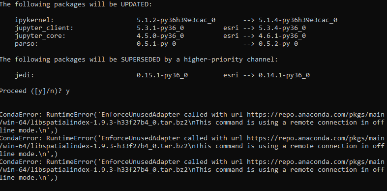

Hi Dan,
I cloned my ArcPro environment, restarted my computer, and ran "conda install spyder --no-pin" as you suggested.  I get an error saying the command is using a remote connection in offline mode.  Do you have any suggestions for getting around this?
DanPatterson_Retired
MVP Emeritus
never seen that.  You are on your own machine ... ie no weird 'office' stuff (ie firewalls etc? )
You could try later, maybe with all that is going on, things are a bit 'off' occasionally
DryCreekEng
Thank.  Yep, Im on my own desktop so no firewalls or other blockers.  I'll try again later.
