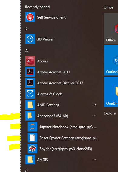

Just installed pro 2.5 and cloned  the default environment.  When I click on the start menu navigate to Anaconda3(64-bit), I find Jupyter Notebook, Reset Spyder Settings and Spyder.  However, they all point to my old (2.4.3) environment.
My spyder desktop shortcut  points to the old env, but I would expect that.  After changing the paths to the new env, it works, albeit with the older 3.3.6 version; again not unexpected.
Where did the Anaconda3(64-bit) folder come from in my start menu, and how do I convince it to choose the right path?
