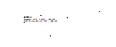

Example 1:  The Fundamental Code to Create Labels Using this Technique
The labels shown in this picture were created by the code below.  The related intersection event table used to create these labels contains over 130,000 records, all of which are read into the dictionary when the first label is processed.  These labels took less than 9 seconds to draw.
To use the code below I went to the Label tab of the Routes and checked the Label check box.  Then I pressed the Expression button for the labels, I changed the Label Parser from VBScript to Python.  After checking the Advanced expression option, I placed the code below in the expression editor.  This expression creates a label for my layer of linear referenced Routes shown above and includes data from a related table of intersection linear reference events.  It lists the Route ID (ROUTE_NAME) in the header of the label in 12 point Bold font.  Under that I show a summary count value of the number of intersection cross street names contained in the related table in 10 point Bold font.  Then I list the related cross street names and their event measure value for each intersection in the regular 8 point font.  The list of cross streets is sorted as a list based on the measures so that they appear in driving order going in the direction of the route's measure orientation.

Example 2: Adapting the Code to Produce Table Style Labels
The labels shown represent only one of the possible ways I could have summarized and/or listed the related feature class/table data.  A semi-tabular presentation is possible if I use a fixed-spaced font like Courier New.  A method for making a tabular style label was given in this post‌ by Jennifer Horsman; however, her code used VBScript and used an inefficient search cursor algorithm.  Below I have adapted her code to use Python and the much more efficient dictionary algorithm shown above.

The code above results in this output:
Example 3: Another Table Style Label Alternative
Here is an alternative table style layout.  The code below includes all of the code shown in the previous example through line 36, but replaces the code that began in line 37 in the code for example 2 as follows:.
  # variables to adjust table cell sizes

With some adjustments to the label style and using the Maplex Label Engine, the example 3 code variation can produce an output that looks like the example below:

    RyanOk
    Occasional Explorer
    Hi Richard,
    thanks for sharing this! not sure you are still following this but would you be able to have a look my modifications?
    The issue is that not all labels are showing up. It only shows other label one by one when i change extent.
    ### Reference
    ### https://community.esri.com/t5/python-blog/creating-labels-with-related-table-data/ba-p/884167
    ### Editing Version
    import arcpy
    # Initialize a global dictionary for a related feature class/table

    one thing to comment, i added import arcpy line at very first. Again, not sure your code should've worked without it but i had to add this, otherwise i was getting error "NameError: name 'arcpy' is not defined".
    thanks so much!
    Ryan
    BlakeTerhune
    MVP Alum
    @RyanOk This may be a labeling issue in ArcMap. Try the option to place overlapping labels and troubleshoot the issue from there. Is the content of all the labels correct? If so, your script is fine and the issue is with the dynamic labeling options.
    RyanOk
    Occasional Explorer
    Hi Blake,
    I'm doing this work with ArcGIS Pro so not sure i can say it's an issue in ArcMap.
    I tried with the place overlapping option too but didn't get luck.
    And yes, it shows all contents what it supposed.
    then if the script is fine, this could be a bug i guess?
    BlakeTerhune
    MVP Alum
    Place overlapping labels—ArcGIS Pro | Documentation
    That doesn't show all the labels?
    Again, if the contents of the labels that do appear is correct, the issue is likely with your labeling scheme. You could contact Esri support.
    RyanOk
    Occasional Explorer
    That unfortunately did not work. I will contact Esri support to see if they can help with this.
