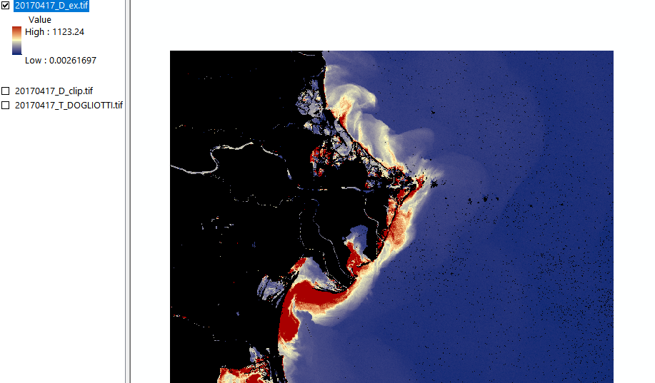

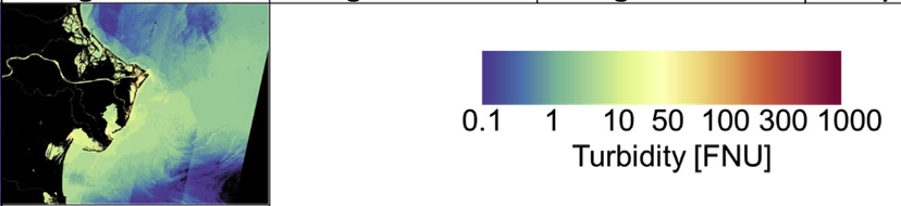

I am trying to reproduce the same characteristics of a raster tif than the same attached in the picture.
I have a raster tif with different value. I already excluded all values above 1000 as they are land area.
I now want to have a descrete color ramp or stretched color ramp, but want to adjust it with certain values/breaks where the colour changes. it should look like this:
But I just achieved this:

Now, I can set them manually, but I can not change the values in between. What I mean is: I want also a legend like above, showing the value steps between min and max with the values and like to adjust them manually so from 0.1-1, 1-10, 10-50, 50-100, 100-300 and 300-1000, but still as stretched color. Now it looks like this:

Okay, I did the labelling. Changed number of intervals and as I don't want the same intervalls I tried to change the values manually, but didn' work. I type in the right value, but it switches back to the original value.
