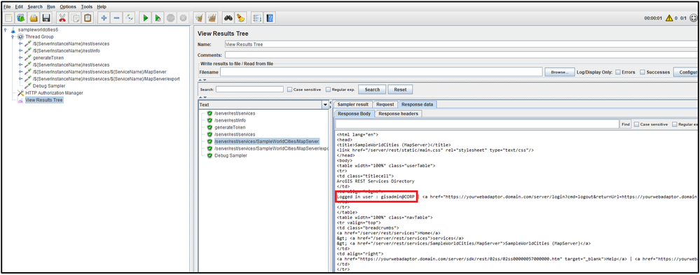

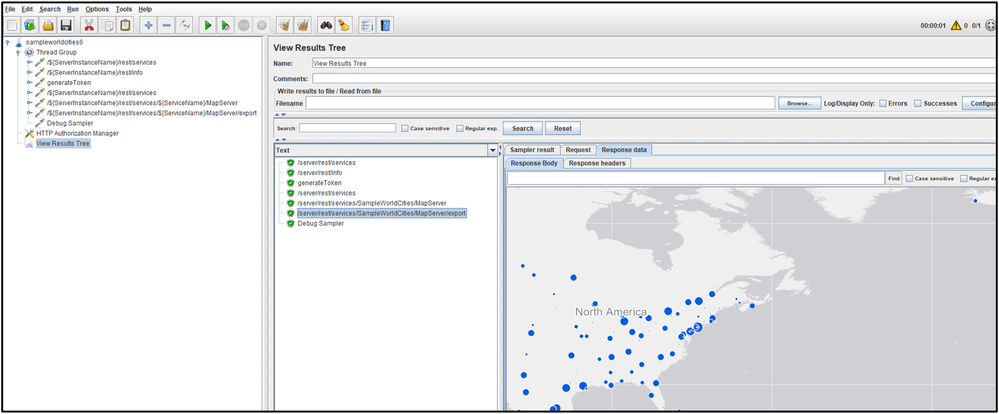

  • The NTLM authorization is handled by the HTTP Authorization Manager element. This is set to read in the credentials defined in the User Defined Variables section, but this could also be CSV Data Set Config file driven.
  • For me, there were a few ways to tell that I was logging in as the intended domain user
    • The services REST endpoint would display the "Logged in user" up at the top of the page
    • The HTML response body is shown below:
    • Another verification was the last request in the test, an export map call to the SampleWorldCities that is only accessible to members of organization (e.g. the ArcGIS Enterprise Site):iwa_sso_logged_in_user_exportmap.png
Note: Even with IWA/SSO, a token is still generated and used to access the service.
