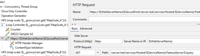

HTTP Request
Essentially, all of the test logic above exists just for this component of the test. Here, the JMeter HTTP Request object can read-in the JMeter variables for specific key/value parameters that have been populated by the JSR223 Sampler immediately before it.
Since this approach is highly programmatic, there is only one HTTP Request per map scale! Such a design favors maintainability.

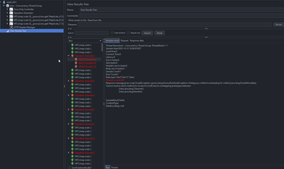

Validating the Test Plan
As a best practice, it is always a good idea to validate the results coming back before executing the actual load test.
  • Use the View Results Tree listener to assist with the validation
    • The Test Plan includes a View Results Tree Listener but it is disabled by default
      • Enable it to view the results
  • From the GUI, Start the test
Transactions
  • Select one of the "HFS" Transactions
    • The results should resemble the following:
  • In this example, the transactions listed above: HFS (mapscale: 72224), HFS (mapscale: 36112), and HFS (mapscale: 144448) all completed successfully
    • The Sampler result lists some more details
      • Although each Transaction sent one HTTP request per feature query extent, the JMeter test is counting the Sampler as part of the operation
        • The JSR223 Samplers add very little overhead to the Transaction although they do double the number of samples, this is just a detail to be aware of
  • Take a quick glance at the Size in bytes
    • In this example, the Transaction Size was almost 65KB which suggests some data was being returned and the responses were not "empty"

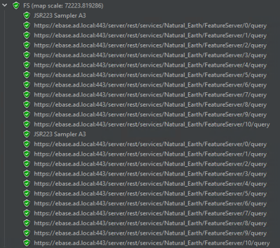

Requests
  • Expand one of the "HFS" Transactions
  • Select one of the https requests
  • In this example, the select request completed successfully
    • In this example, the Request Size was about 5KB which suggests some data was being returned and the responses were not "empty" (e.g. 1500 bytes)
  • The ContentType is also important
    • Per the parameters in the Test Plan, the requested format is pbf which returns application/x-protobuf
      • Requesting protocol buffers is a best practice as it optimizes the payload
        • The resulting format is binary and cannot easily be viewed without additional help that is not covered in this Article

JoshBillings
Hey @AaronLopez, thanks for this write up! I am currently trying to complete this test plan but am getting an error with the Operation Generator (see image).
Any chance you'd know what's causing this?
AaronLopez
Hi @JoshBillings,
The operation logic is fairly simple in that it just performs some JMeter variable retrieval and a little Groovy arithmetic. Can you confirm what version of JMeter and JavaSDK you are using?
Thanks.
Aaron
JoshBillings
@AaronLopez I am using JMeter version 5.6.2 and OpenJDK version 17.0.2
Thanks,
Josh
AaronLopez
Hi @JoshBillings,
That combination of JMeter and JDK looks good.
It unclear exactly what issue Groovy is having an problem with.
That said, I tried adjusting the declaration logic to help avoid any ambiguity. I just uploaded a new version of the test: roads_hfs3.zip. Please give this one a try.
This new test ran fine with using OpenJDK17.0.2, OpenJDK20.0.2, OpenJDK11.0.2 and OpenLogic8u382. But if you still encounter issues, try downgrading the JDK (e.g., to 11 or even 8).
Hope that helps.
Aaron

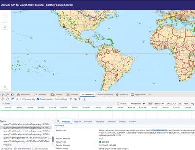

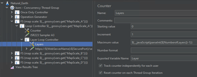

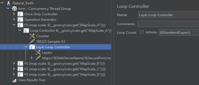

StevenBeothy
Hi @AaronLopez
Thank you for all your great work with these JMeter blog posts!
I wanted to ask your thoughts on this Feature Service sample, I noticed this test plan queries the first layer id of '0' for each request.
If a Feature Service has multiple layers (eg. 11) is it feasible to change the test plan like I did below?  I supply a variable for the user to enter the number of layers in their Feature Service and then include a nested loop in your 'LoopController' to pass the query parameters for each layer id?
I understand this will make the load test much heavier than the original but if it aligns with the how the users interact with the Feature Services if they're viewing all of the data and not just a single layer, would you consider this a valid test plan?
AaronLopez
Hi @StevenBeothy
I think that test plan is valid and a good programmatic way to get a performance profile from each of the layers
However, there are a few items worth mentioning:
  • My roads_hfs test requested * for the outFields
    • This is fine but can be considered aggressive, especially if the tables are "wide" (e.g., 50 or more attributes)
    • In that case, I would consider maybe asking for a few specific attributes (e.g., OBJECTID plus one or two others)
    • But, that assumes the requested attributes exist in all the layers
      • This is why using * is so easy
  • My roads_hfs test was build around using hosted feature service queries (e.g., where resultType=tile)
    • I am a huge fan of the feature tiles and their data structure lends itself to efficient querying (repeatable extents for better caching, more predictable quantization tolerances for each of the layers)
    • A resultType of say standard would be similar but the test logic would be different (and in my opinion, more complex)
      • Additionally, requests with resultType=standard can ask for varying numbers of records being returned (through the use of the resultRecordCount and resultOffset parameters)
        • This adds variance and test complexity...which again is why I like testing with resultType=tile
To reiterate, I think your approach is good and resultType=tile style tests are a great way to consume a feature service.
I bring up these other items to give my opinion and perspective on what your test is doing and how its asking for the data...as well as the potential test logic impacts when asking for feature data when the resultType is not tile.
Hope that helps.
