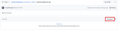

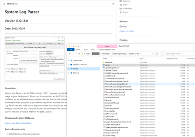

@AaronLopez the current zip file download for SLP is giving me an empty zip file.
https://github.com/AaronPLopez/SystemLogParser/raw/main/binaries/latest/SystemLogParser.zip
Bernie.
NoahMayer
@berniejconnors when I clicked the link in your comment I got the files...
When I go to https://github.com/AaronPLopez/SystemLogParser/tree/main/binaries/latest , right-click SystemLogParser.zip and select "Save link as" I'm also getting an empty zip file.
When I go to https://github.com/AaronPLopez/SystemLogParser/blob/main/binaries/latest/SystemLogParser.zip and click the "Download" button on the right, I'm getting the files.
AaronLopez
Hello Bernie,
I just tried downloading the zip and was able to open it with the expected contents.
Can you try download it from another computer and/or another web browser?
@NoahMayer ...a good point about the "Save link as" option. I was not aware.
@berniejconnors, If you click the SystemLogParser.zip link (from the latest page), and select Download, this should give you then full zip file.
