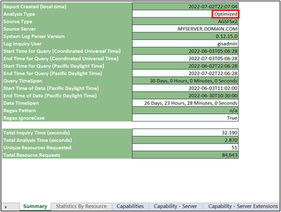

  • The Optimized Analysis Type option shown in the GUI:
A System Log Parser spreadsheet report generated using the Optimized option:

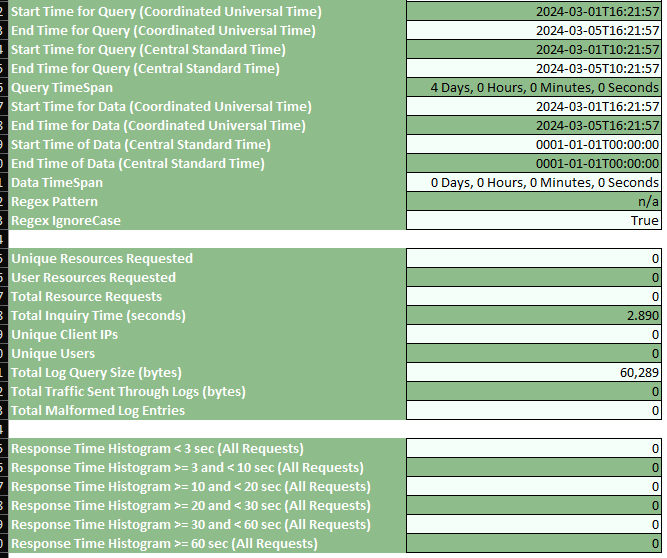

Do we know if there are any compatibility issues with this tool and the ArcGIS Enterprise 11.2 software?
I recently set this up and ran it on one of our servers, however it doesn't look like it is working properly.
It completed and shows a start time and end time for the query and timing for the Start/End Time for Data (Coordinated Universal Time), but it doesn't show a Start/End Time for Data (Central Standard Time), plus the Data TimeSpan value is 0 along with a lot of the other values from Unique Resources Requested down.
Am I not filling something out right or is there an issue with 11.2?
Thanks,
AaronLopez
Hi @ghaskett_aaic,
My guess is that your 11.2 Site and System Log Parser are fine.
There are two conditions that exist that can lead to the situation of the generated report listing 0 hits.
  • The LogLevel of ArcGIS Server is set to a value of either Warning, Error or Info
    • The statistics in the System Log Parser report are based on elapsed time request entries, but this requires the LogLevel to be set to Fine
    • Verbose and Debug work too but they not recommended for Production sites due to how much detail is recorded
  • There were no requests to the Site during the specified log query duration (e.g.,  2024-03-01T10:21:57 through 2024-03-05T10:21:57)
    • For a quick check, authenticate to the Site from the REST service endpoint, select a service, pan or zoom around a few times, then generated the report with an end time that includes those requests (e.g., end time = now)
    • This report should include your requests that were just made to the Site
