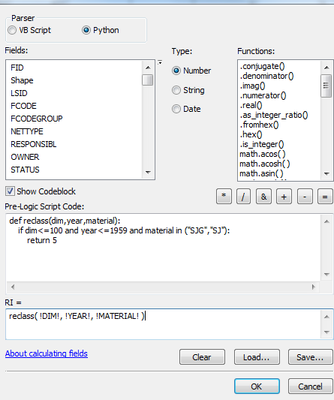

This has also worked for me (Parser: Python).
Code Block:
def reclass(dim,year,material):
    if dim<=100 and year<=1959 and material in ("SJG","SJ"):
        return 5
Expression:
reclass( !DIM!, !YEAR!, !MATERIAL! )

GjermundDeggerdal
Thank you very much for your helpfull respons! I am truly sorry if my follow-up questions are stupid and basic, but I`m stuck.
I have probably done something wrong, because I can`t get this command to work.  I wrote it in like this (Copy - paste from your post). Is there something more I have to add to the statement?
And I dont understand why you don`t need exclamation marks around the variable inside the pre logic script, this seems diffrent then in VB Script?

GjermundDeggerdal
Thanks, Your code worked perfect with copy-paste, the problem was that i had empty values "Null" and shape did not allow it. I converted it to gdb and it worked right away! Cheers!
