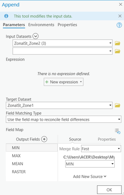

4. Use Append. The previously created table would be your target dataset. And link the output table of Calculate Field, as your input datasets.
Change Field Matching Type to "Use the Field Map to reconcile schema differences"

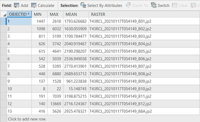

Here is how my target table looks like, after running the model.
