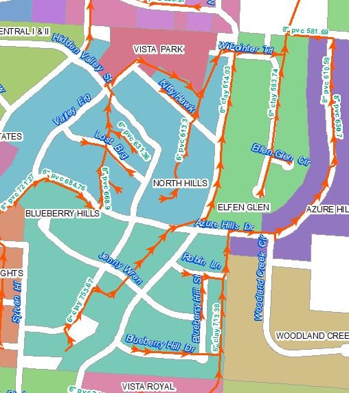

really needing help with this. See the attached image. I have subdivisions represented by polygons, and within those polygons, I have more data representing sewer lines. I need to query certain size lines, within the subdivision polygon and am not sure which geoprocessing tool to use.
For example.....looking at the image.....how would I query 6" sewer lines with the North Hills Subdivisons.  Each set of data, (sewers and subdivisions) are in separate shape files.

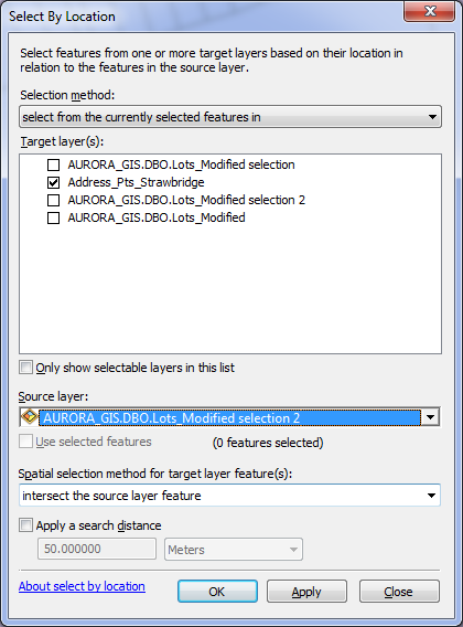

CoryMacNeil1
Hi Mike,
Take a look at my Select by Location Window.  Notice that the Selection Method is set to ‌select from the currently selected features in

how about "subset". See attached image.  Also, I'm a bit concerned that I may be using a different tool than you. Mine says "select layer by location" and your says "select by location"subset.JPG
CoryMacNeil1
SUBSET_SELECTION should work.  You can use the Selection menu at the top of the screen and when you do the Select By Location option becomes available.  Essentially the same thing.
