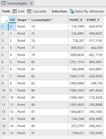

 The Shapefile table

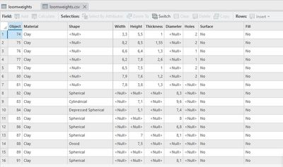

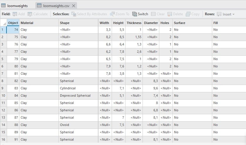

The csv file (imported on ArcGIS)

and what were the join fields?  I see at least 1 field that looks like a number but is left justified, meaning it is text and not a number

The join fiels are "Loomweight" from the Shape File and "Object" from the csv file

As suspected,  Loomweight is a text field (left justified) and Object is numeric (right-justified),
You can't join numbers to text EVEN if they both look like numbers.  A common issue.  cast one of the fields into a new field to the opposite of what it is using the field calculator (eg int(Loomweight) in a new integer field like LoomWght2)
