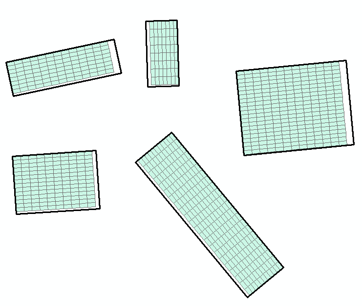

Here's my attempt. It's not necessarily the optimal. You could rotate the grid axes and compare to see which holds the most rectangles. There is also the distinct possibility that neither orientations optimally fill the original rectangle (i.e. there is often a remainder that could fit more small rectangles rotated by 90 degrees).
recs = 'recs' # rectangle feature layer
mbr = arcpy.MinimumBoundingGeometry_management(recs,r'in_memory\mbr',mbg_fields_option='MBG_FIELDS') # get MBRs
grids = [] # merge list to be populated
out_grid = r'in_memory\out_grid' # final output
sr = arcpy.Describe(recs).spatialReference # CRS
grid_h = 20 # cell height, aligned to long axis of rectangle
grid_w = 10 # cell width, aligned to short axis of rectangle
with arcpy.da.SearchCursor(mbr,['SHAPE@','OID@','MBG_Width','MBG_Length','MBG_Orientation'], spatial_reference=sr) as cursor:
    for row in cursor: # loop through MBRs
        grid = r'in_memory\grid_' + str(row[1]) # temp grid
        dy = math.cos(math.radians(row[4])) * row[3] # y diff along long side
        dx = math.sin(math.radians(row[4])) * row[3] # x diff along long side
        y_axis = str(row[0].firstPoint.X + dx) + ' ' + str(row[0].firstPoint.Y + dy) # rotation point
        origin = str(row[0].firstPoint.X) + ' ' + str(row[0].firstPoint.Y) # starting point
        arcpy.env.outputCoordinateSystem = sr # set CRS for fishnet
        arcpy.CreateFishnet_management(grid,origin,y_axis,grid_w,grid_h,int(row[3]/grid_h),int(row[3]/grid_w),labels='NO_LABELS',geometry_type='POLYGON') # make fishnet
        temp_lyr = 'sel_' + str(row[1]) # temp layer
        arcpy.MakeFeatureLayer_management(grid,temp_lyr) # make feature layer
        arcpy.SelectLayerByLocation_management(temp_lyr,"WITHIN_CLEMENTINI",row[0],selection_type='NEW_SELECTION') # select grid cells inside MBR
        arcpy.SelectLayerByAttribute_management(temp_lyr,"SWITCH_SELECTION") # switch selection
        arcpy.DeleteFeatures_management(temp_lyr) # delete cells outside MBR
        grids.append(grid) # add to merge list
arcpy.Merge_management(grids,out_grid) # merge‍‍‍‍‍‍‍‍‍‍‍‍‍‍‍‍‍‍‍‍‍‍‍‍‍‍‍‍‍‍‍‍‍‍‍‍‍‍‍‍‍‍‍‍‍‍
