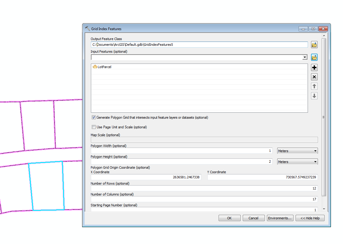

The best I can think is to run Grid Index Feature tool. On your polygons.  You can specify exactly a 1 x 2 meter polygon. However they will be aligned north south etc.
Then use the Select by location tool to select all grids that intersect the boundary and delete them.

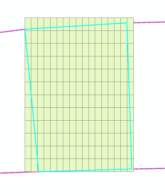

AndreasEugster2
Deactivated User
Thank you Robert, I tryed to do it with the gridindexfeature. Works kind of, except (as you said) for the North-South arrangement...and the arrangement is very important
So far it is the best solution but I still not what I try to find...
I'll try to find out how to get the generated gridindex into the right arrangement.... What i further have is the aspect of the "to be filled polygons"..
so maybe I can integrate this aspect into the gridindex ?!...
Still thankful for your help
And if I find out something I'll let you know here
DanPatterson_Retired
MVP Emeritus
you still should be able to use rotation...
