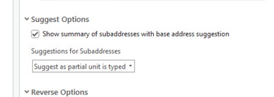

I have also enabled sub-address suggestions in my Locator properties Suggestions for partial subaddresses.

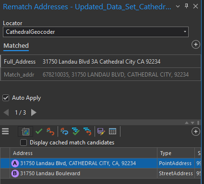

Any recommendations when you have a main address and subaddresses, but the Geocoder wont find it until you type it in perfectly?
IE: Input Type = Single Field
Input Address: 31750 Landau Blvd 3A Cathedral City CA 92234
Only finds if I adjust the '3A' to 'A3' and then it finds its?
Do I have to remove the 'Unit Type' in the Locator?
Or maybe I need to spend more time breaking up the address to multi fields?

Did you look at the Suggest options in the Locator properties?
