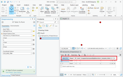

Using XY Table To Point with this very simple .CSV file, the field names are not truncated and are read in full as expected. I am using ArcGIS Pro 3.1.2. Do you see something different to this ?
ID,short,longqwertyuiopasdfghjklzxcvbnm,program_status,x,y
1,1,1,1,10,10
2,2,2,2,20,20
1,1,1,1,10,10
2,2,2,2,20,20
